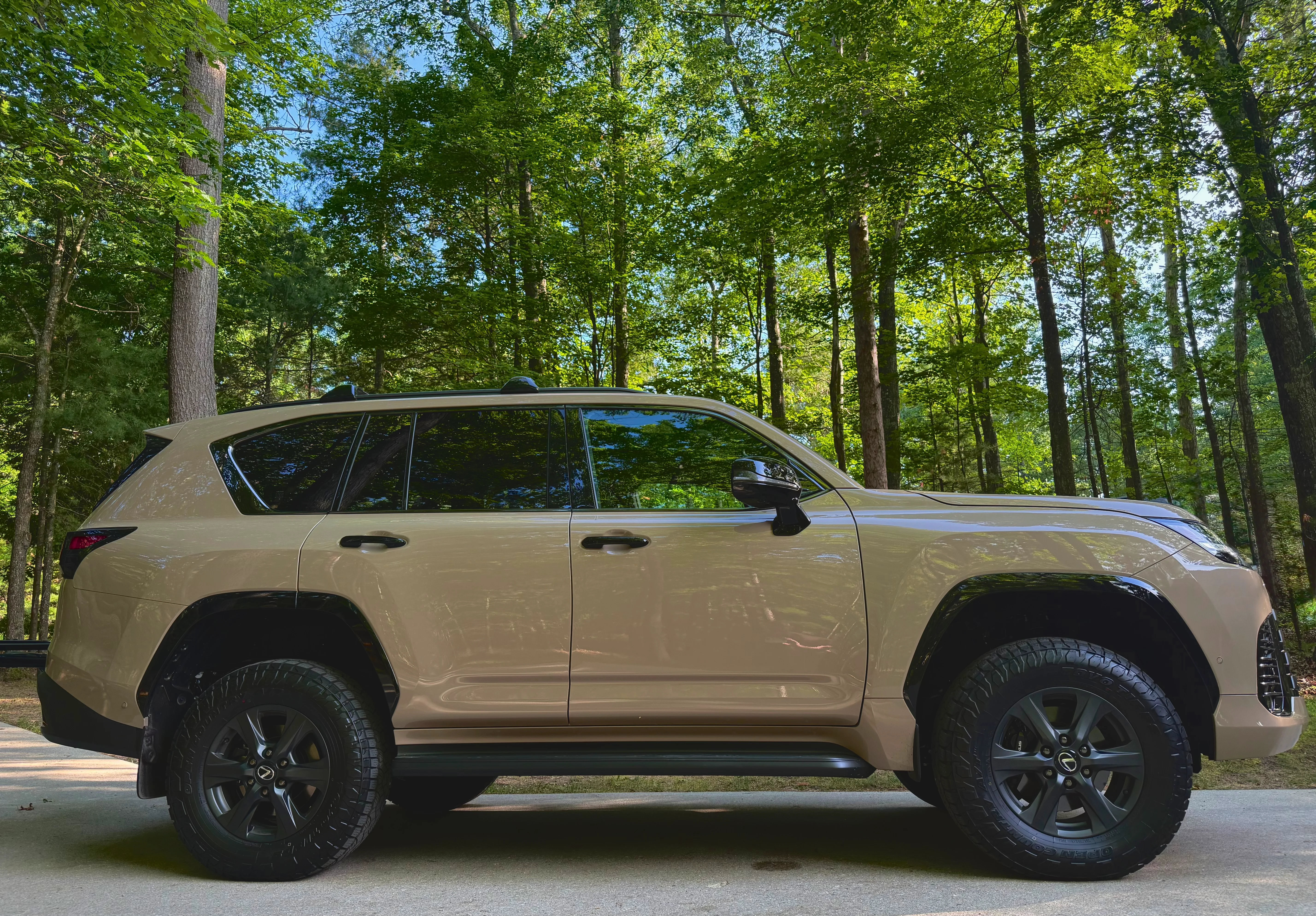

We got the LX 700h Overtrail April 2025. The wind noise was immediately noticeable! I was unable to walk over to that beauty with a pry bar so lived with it for 12 months. Today I found a YouTube video of how to remove (since there is no guidance from Lexus). It was easy and made a World of difference! DB level is halved! Love our LX, and now I can drive it without that obnoxious noise. Pic before attached. Here it is
