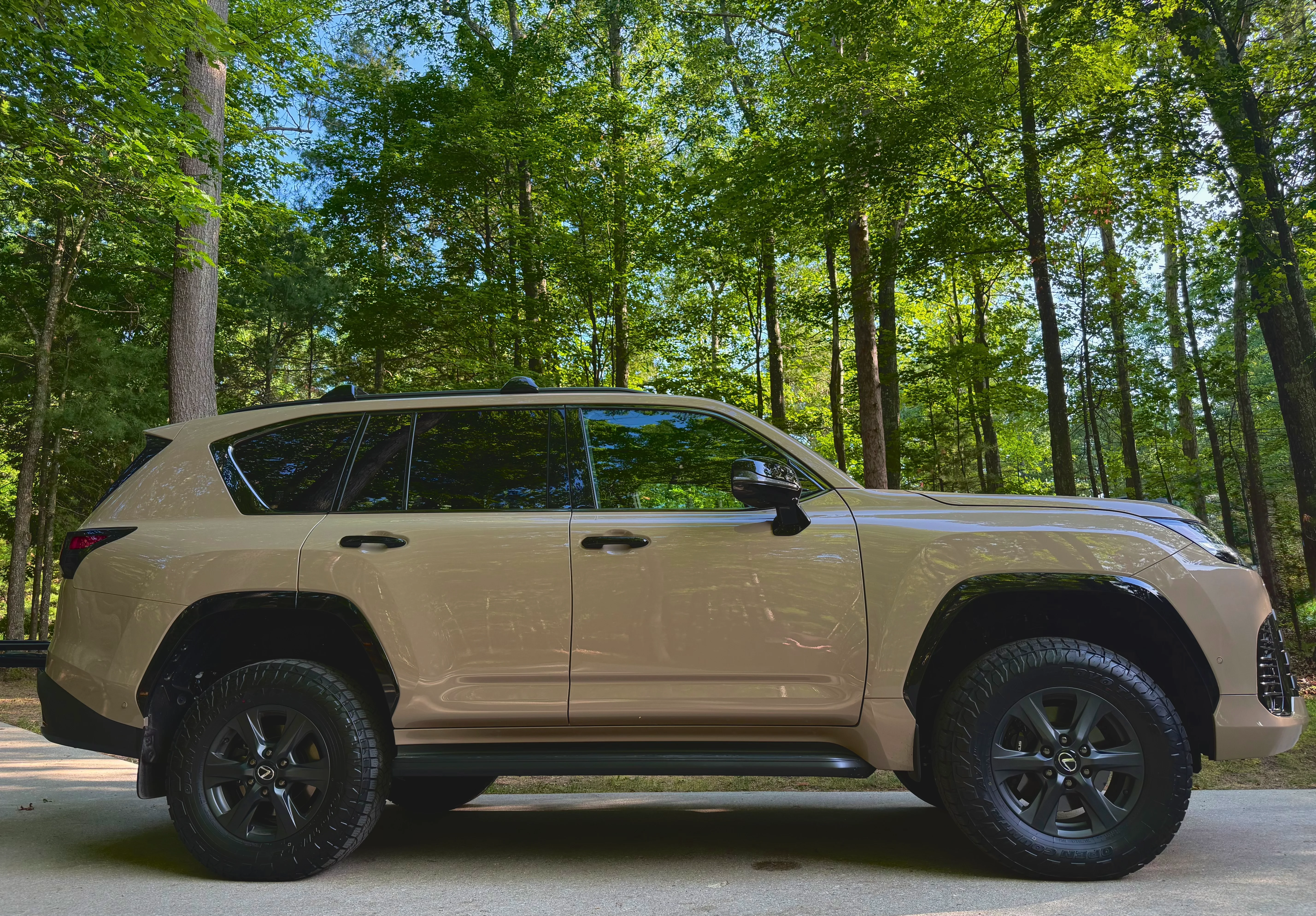

We have an LX 700h Overtrail purchased in March 2025. We test drove the Lexus GX 550 Overtrail Plus the same day and decided on the LX, there was really no comparison. And in fact the Mark Levinson in the LX was one of those items you simply cannot compare in any objective way. I have had BMW's, Mercedes, etc. and I can tell you I have never heard any automobile stereo system that is even close. But there is more to a stereo than just the amp and speakers. If your car is not quiet, hushed and refined more volume is not going to help. The LX is the quietest vehicle I have ever driven. I have a theory about any suggestion the Levinson in the LX is not great and that is, if you play your favorite song from the 70's with terrible production no sound system will make it sound good, yet people think it's Mark Levinson, it will make anything sound good, no! I have also seen reviews of great songs to listen to on a great car stereo and even some of those are really off! Some old albums they liked but again, terrible production or just not up to today's standards. If you get one and you wonder if it sounds not too great, go to Apple Music, pay $1.29 and get Slightly Stoopid 2AM. Once you hear that song on that system you will know, the Mark Levinson in the LX (Not other Lexus models, but the flagship LX) is outstanding! ANd I had to share a photo of my girl of course.
