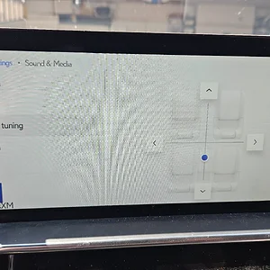

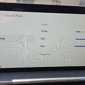

So I love my week-old LX700h. What a ride! But the ML stereo SUCKS! It is NOT a full-length, 3-row system. ONLY the front speakers put out the main sound. From there all the way back the speakers just output "surround sound". So the 2nd and 3rd row folks just get low-volume "echo" sound. You can confirm this my fading all the way to the rear speakers (bottom of the touchscreen chart) then turning the volume up. All the ceiling, door, and rear speakers output only "echo/surround". TOTALLY UNACCEPTABLE! ME=PISSED! 2D mode is BETTER but the tone still sucks. Need to crank the bass up, mid alone, and treble down. It helps!
