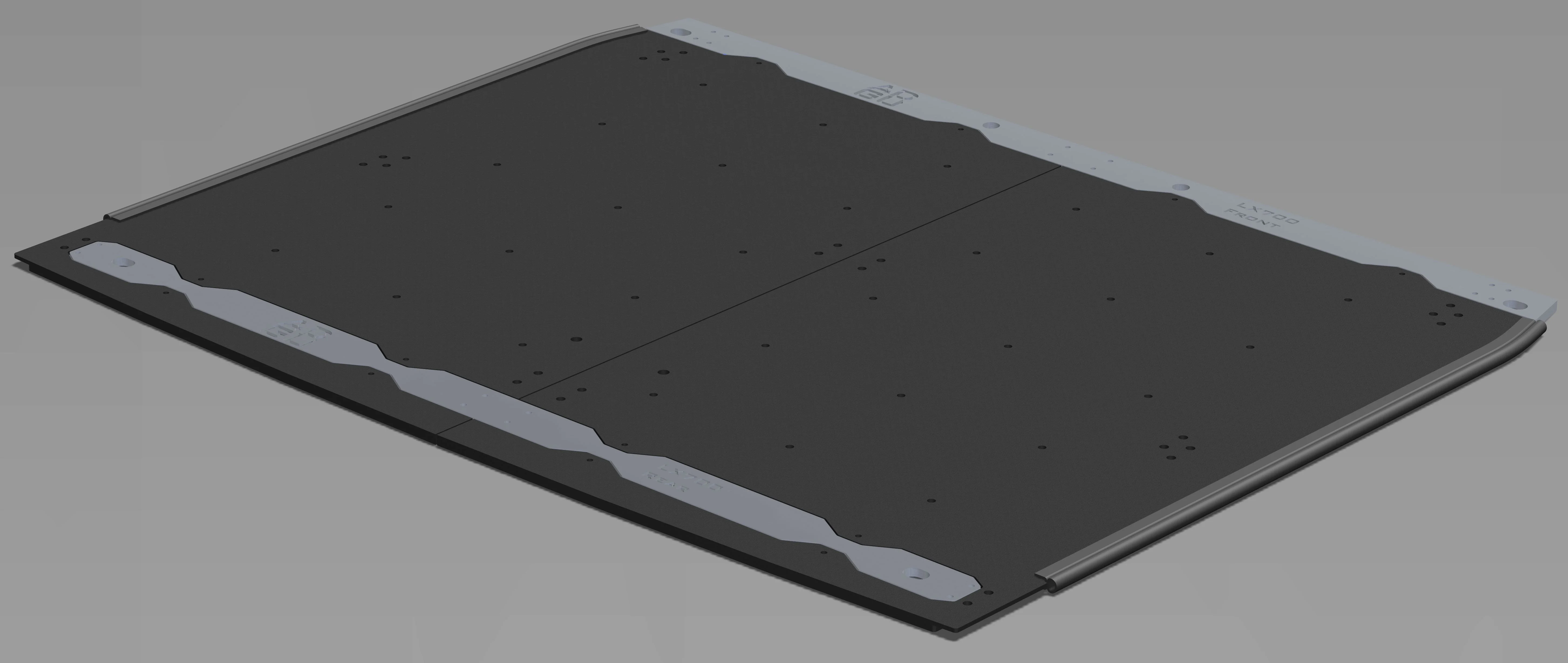

By popular demand, we are bringing out an LX700h 3rd row seat delete!
With the release of our drawers, sleeping platform and kitchen we received a lot of requests for a 3rd row delete product.
This will consist of our existing all-metal anchoring system, which requires NO drilling and utilizes proprietary brackets mounted into existing OEM threaded holes to provide an incredibly robust mounting point for the floor plate. We will still use this existing "anchor bars' which are solid aluminum, and the floor plate itself will be an aluminum sheet metal design that will have a texturized black powder coating.
This will be a load-bearing structure with the intent of supporting a few hundred pounds. It will also have mounting provisions for your choice of cargo lashing hardware, (i.e. l-track, d-rings, etc). The delete blocks off access to the hybrid battery, it is inteded to prevent loose items from falling into the battery area.
Below is a CAD render of the product, which will look almost identical to the current 'floor plate' we have for our drawer system (also pictured below installed)

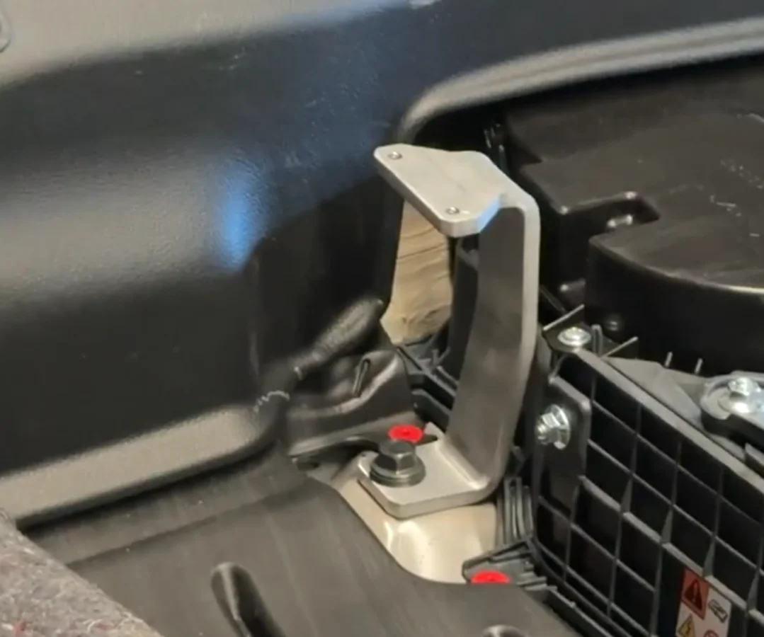

  • Our existing design is showing 750pounds of load capacity (evenly distributed), which seems fantastic. This is intentionally 'overbuilt' with the idea being a lifetime of satisfaction even with abusive use.
  • Panels: The panels will be alluminum with a highly textured black powdercoat
  • Structural rail: Along the far outside lengths of the floor, we will be utilizing aluminum extrusion to provide a substantial amount of the structure needed to achieve the 750pound load rating. This is an essential part of the structure of the system, especially as the driver-side edge of the floor plate is very close to the hybrid battery cables. in accordance with Murphy's law the highest point under that 3rd row the power cables for the hybrid battery. With that in mind we are 'allowing' no flex through that area.
  • Cargo Tie downs: Because the outer rail is required for the structure of the system, it provides a fantastic means of attaching optional cargo tiedowns into the extrusion slot. This definitely feels like a win/win, because without the d-rings installed everything is nice and sleek/clean, and the nature of the extursion means the d-rings can be put anywhere along the length that you'd prefer. We will also provide tapped holes along the centerline that will allow for l-track to be installed. These holes will go out with a flat plug of some kind as the standard offering. @garyculb18 , we discussed a 100% smooth option, let us know what you think about the idea of the plugs down the centerline?
  • Shipping/Installation: The product will be split into 3 panels, which will allow for simple ground shipping: i.e. this can come right to your door via UPS/Fedex. The customer will be responsible for removing the 3rd row (it's not terribly difficult!) assemblign the 3-panels together with a few simple screws, installting the mounting brackets, and then installing the panels to the brackets. We will provide a detailed video along with written instructions to help guide through all this. Our intent is for this to be at level comparable to something like Ikea furniture to install.

Thanks for the feedback! Based on your input, we have worked up a solution for eliminating the top rails while still retaining the load capacity..
As for the holes: No problem having a hole-free design on your floor plate. At the release, we may end up having two versions of this: one with pre-drilled/threaded holes for cargo tie down mounts, one that's totally hole-free.
For the Fan: Great question! That fan is unaffected by the 3rd row removal/floor plate, as that's located in the side-walls of the cargo area

The current design will be BOTH completely flat AND L-track compatible. We did a few things to achieve this:
  • Hidden structural reinforcement: As circled in the Green ovals above, we have moved the structural support to the underside (with some design/material wizardry). To attach the support, we will be utilizing countersunk holes and flat-head screws, which will result in a totally flat/sealed (not water-tight, but no open holes) surface up top In the 2nd picture, i've circled an example of current-product uses of the countersink/flat head attachment method.
  • L-Track Compatibility: For those interested in utilizing L-track for cargo lashing, the L-track will bolt into the existing holes for the under-side reinforcement (green ovals), with the option to attach a just-off-center 3rd rail by utilizing the pre-threaded inserts shown in the yellow oval (ok, ok, they aren't actually shown in this render, but imagine there are some black dots in there) for NON L-track use, these threaded inerts will be blocked by a pre-installed flat head screw; resulting in a flat, sealed surface. here's a picture of the L-track we have in mind. Even with this L-Track in place, you'll have a mostly flat floor. The l-track is 0.4inches tall. You will be able to go back and forth between l-track installed and totally smooth.
  • Shelf Cubby: shown in the blue oval, this is an extension beyod the structural 3rd-row mounts. It's a relatively short piece at about 10 inches. Our intent with this is to create a flat- floor all the way to the backs of the 2nd row seats. The area under this shelf will be accessible by tumbling the 2nd row seats. The thought being you can put your low-use items in there (tools for spare tire swap, jumper boxes, etc)

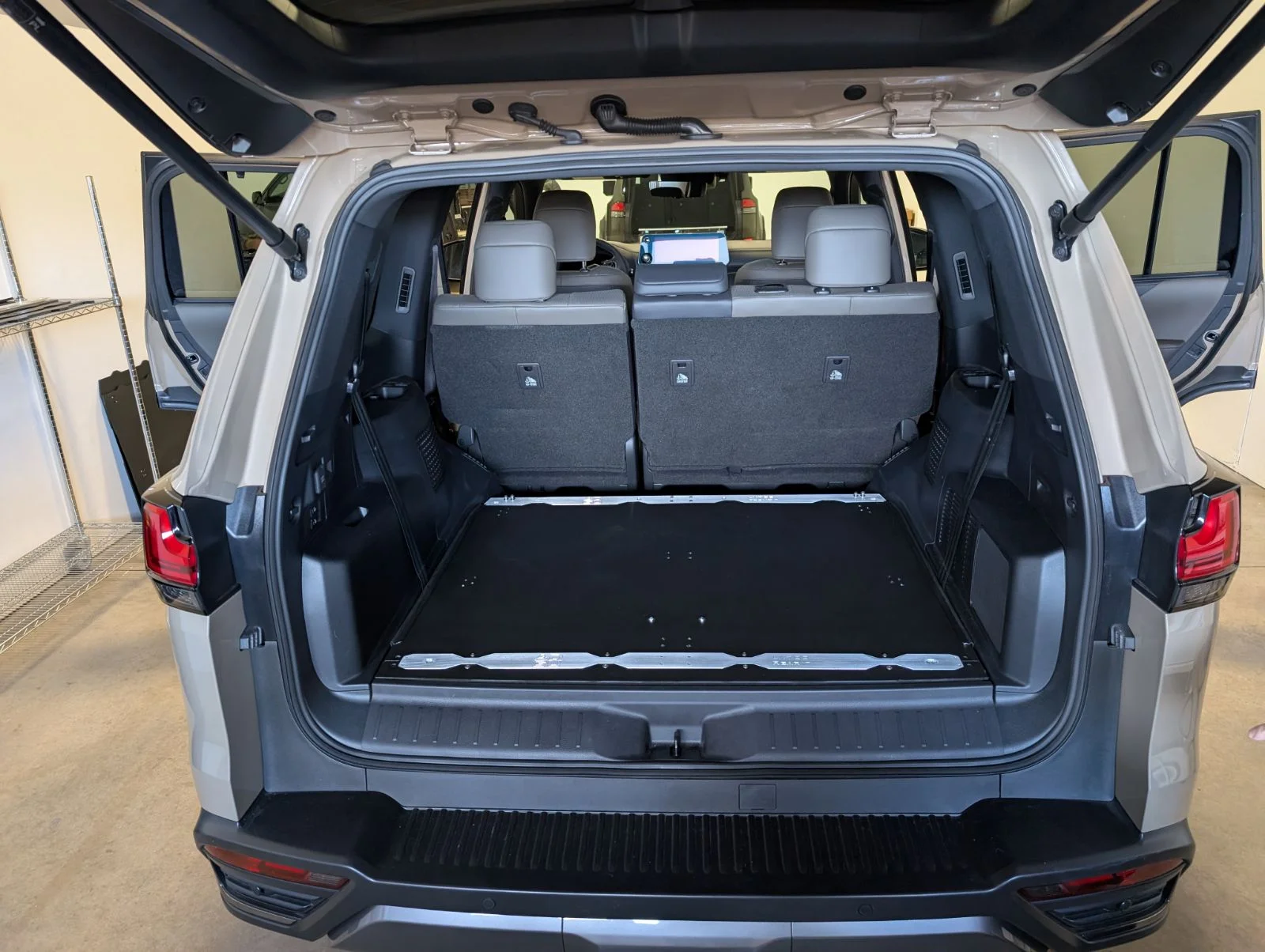

First production-grade unit has been built and is ready for testing in the car! We saw basically no deflection at about 500 pounds of loading, so this is looking good.
This is with the fully-flat top, so our goal of load bearing without needing structure above the plate appears to have been met.

More details to come, but 3rd row delete is installed and looking great! This first install went really well. We have a few incredibly minor changes we'll make and then off to full production!

Our 3rd row delete product has been up a running for a little while now, we are working through the shipiing/installing the first orders, verifying with local installs along to the way for repeatability evaluation and so far so good!
Just sharing a picture from an install today. What other details can we provide?
