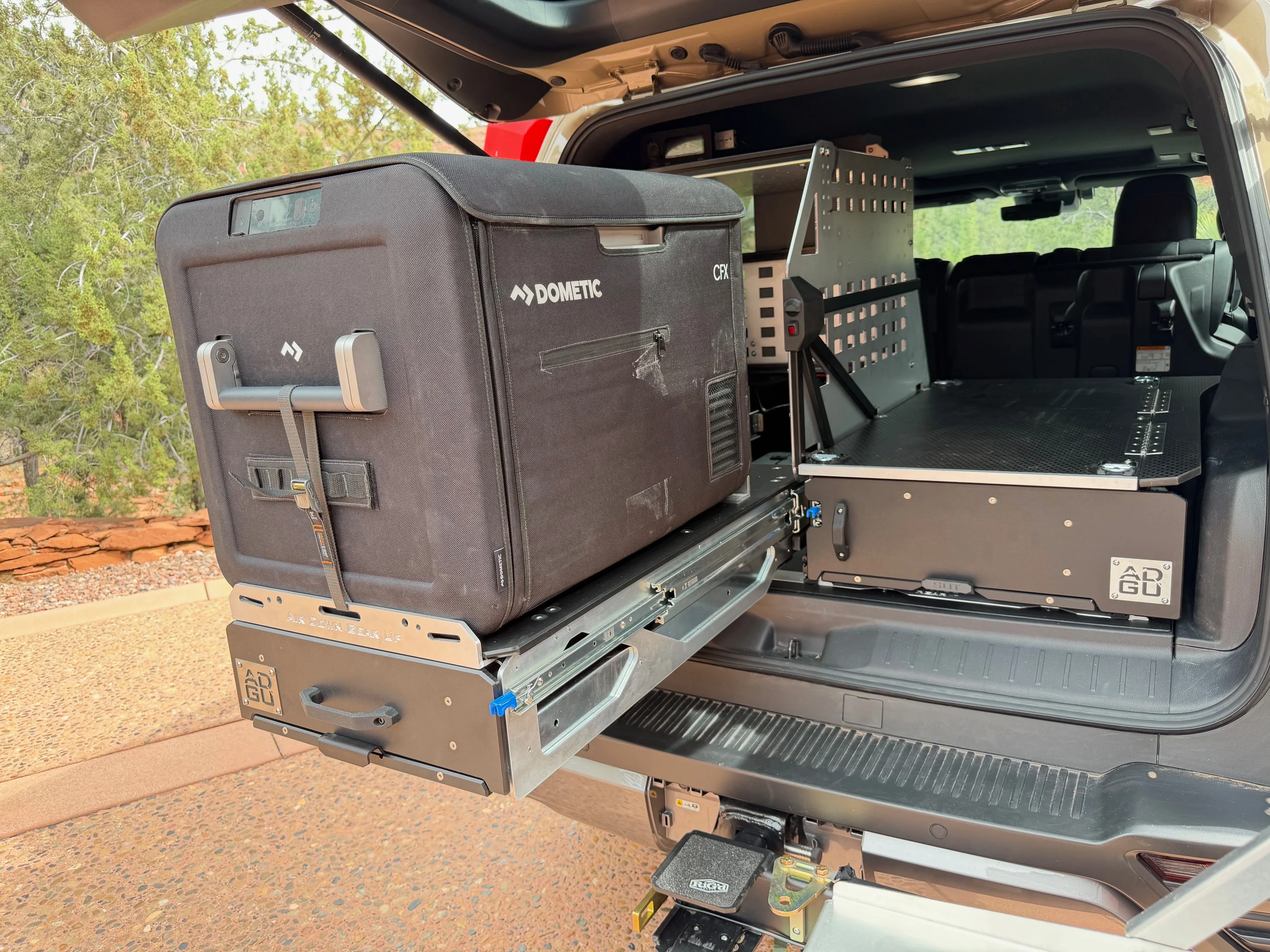

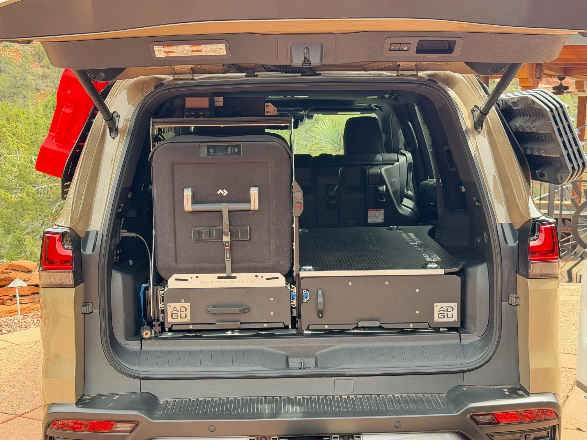

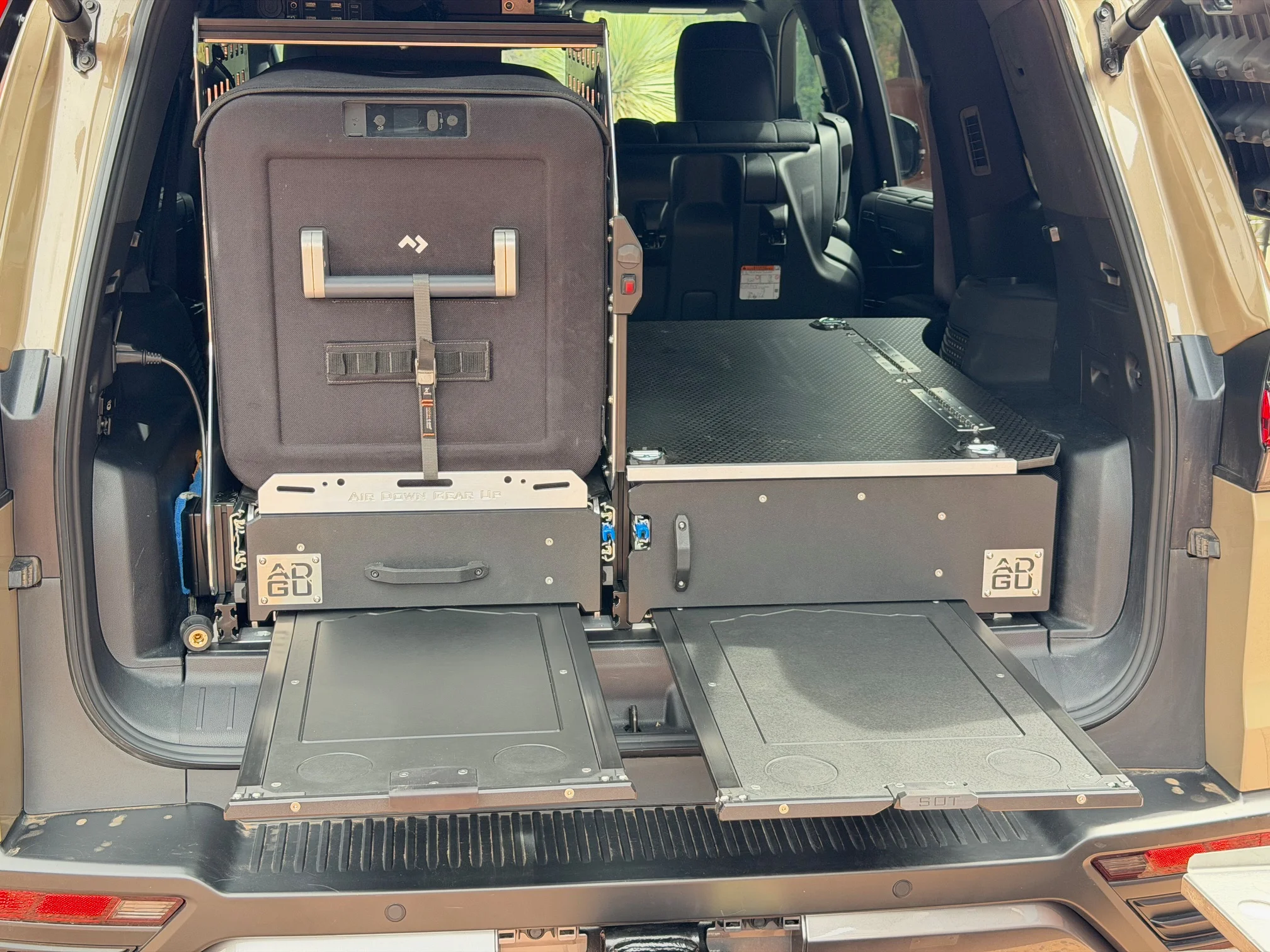

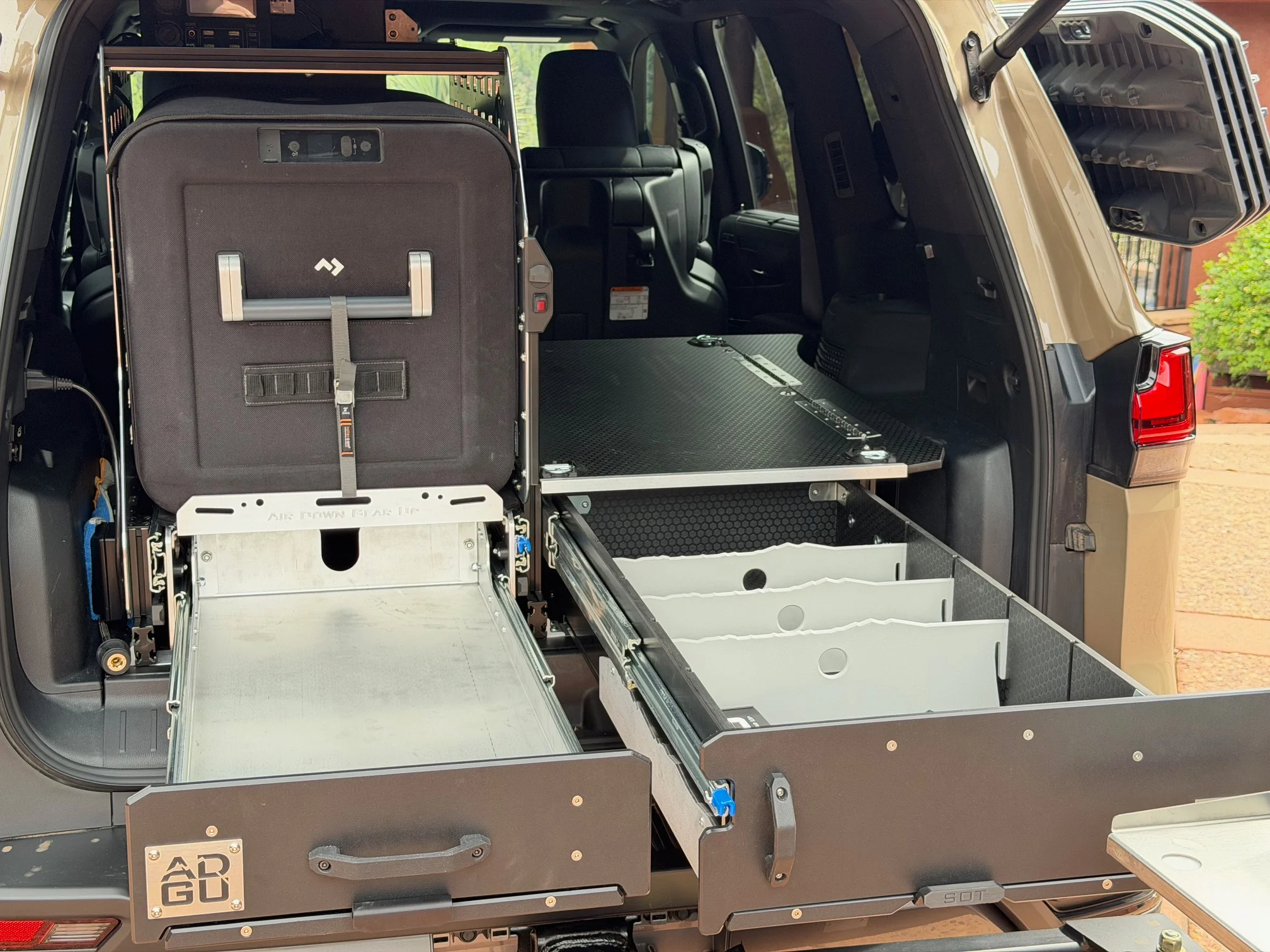

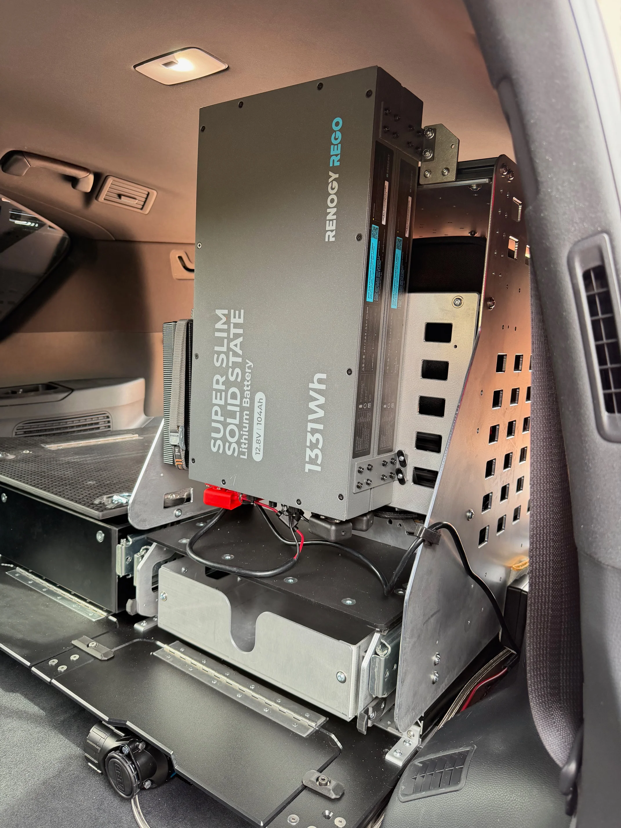

Many months ago I took out the third row to reclaim some cargo space in the back. Over the past few months I have been working with AirDownGearUp in Colorado to create a drawer/fridge rack system for the vehicle. What follows is the excellent result. Truck is now ready for some longer trips. They created new brackets and a solid floor which attach to the original points where the prior seat bracket bolded on. This protects the battery and becomes the foundation of the system. The drawers and fridge rack are connected to that. The system has no rattles at all even when driving on rough washboard roads. The action is smooth and solid. The drawers include pull out trays which almost make for the utility of a tail gate. On the fridge rack, I was able to attach two Renogy solid state batteries to power the fridge and other stuff. I am exceptionally pleased.

I believe AirDownGearUp is partnering with Dissent to create what will go into their vehicle. I found them great to work with and the drawer system is supper solid.

Many months ago I took out the third row to reclaim some cargo space in the back. Over the past few months I have been working with AirDownGearUp in Colorado to create a drawer/fridge rack system for the vehicle. What follows is the excellent result. Truck is now ready for some longer trips. They created new brackets and a solid floor which attach to the original points where the prior seat bracket bolded on. This protects the battery and becomes the foundation of the system. The drawers and fridge rack are connected to that. The system has no rattles at all even when driving on rough washboard roads. The action is smooth and solid. The drawers include pull out trays which almost make for the utility of a tail gate. On the fridge rack, I was able to attach two Renogy solid state batteries to power the fridge and other stuff. I am exceptionally pleased. View attachment 526View attachment 527View attachment 528View attachment 529View attachment 530View attachment 531View attachment 532

At the moment, we aren't pursuing a 1/2width system for the 700H. The mounting becomes just too complicated, as you'd need to incorporate the full-width seat frame.
