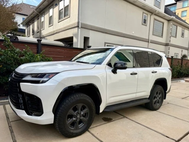

Got my 2026 LX700H Overtrial last month. Already drove around 3K Miles. Great car but really dissapointed in Hybrid system. Turns on/off twenty times within a mile if you are in slow traffic or rush hour. Very annoying and takes away the luxury aspect of this 120K vehicle. Also definitely making a thumping sound everytime engine turns-on/off from battery to engine or vice versa. Took it to a Lexus dealership and there standard response was "thumping sound is normal". Asked for an official email so I can open a complaint with Lexus corporate. There tone changed, manager got involved and now I have an open case with Lexus engineering. As of now they think its the exhaust thats making thumping sound everytime engine turns on/off. They are suggesting "insulator for the exhaust pipe". Once installed I will give you all an update.

Sorry you're not happy. But I suggest you spare yourself some grief and dealer trips. This is 100% normal. Nothing is wrong. And no insulator or whatever will change the experience when that motor restarts. The sound and rumble you hear is from the engine (go outside and listen). It's not from the exhaust.
