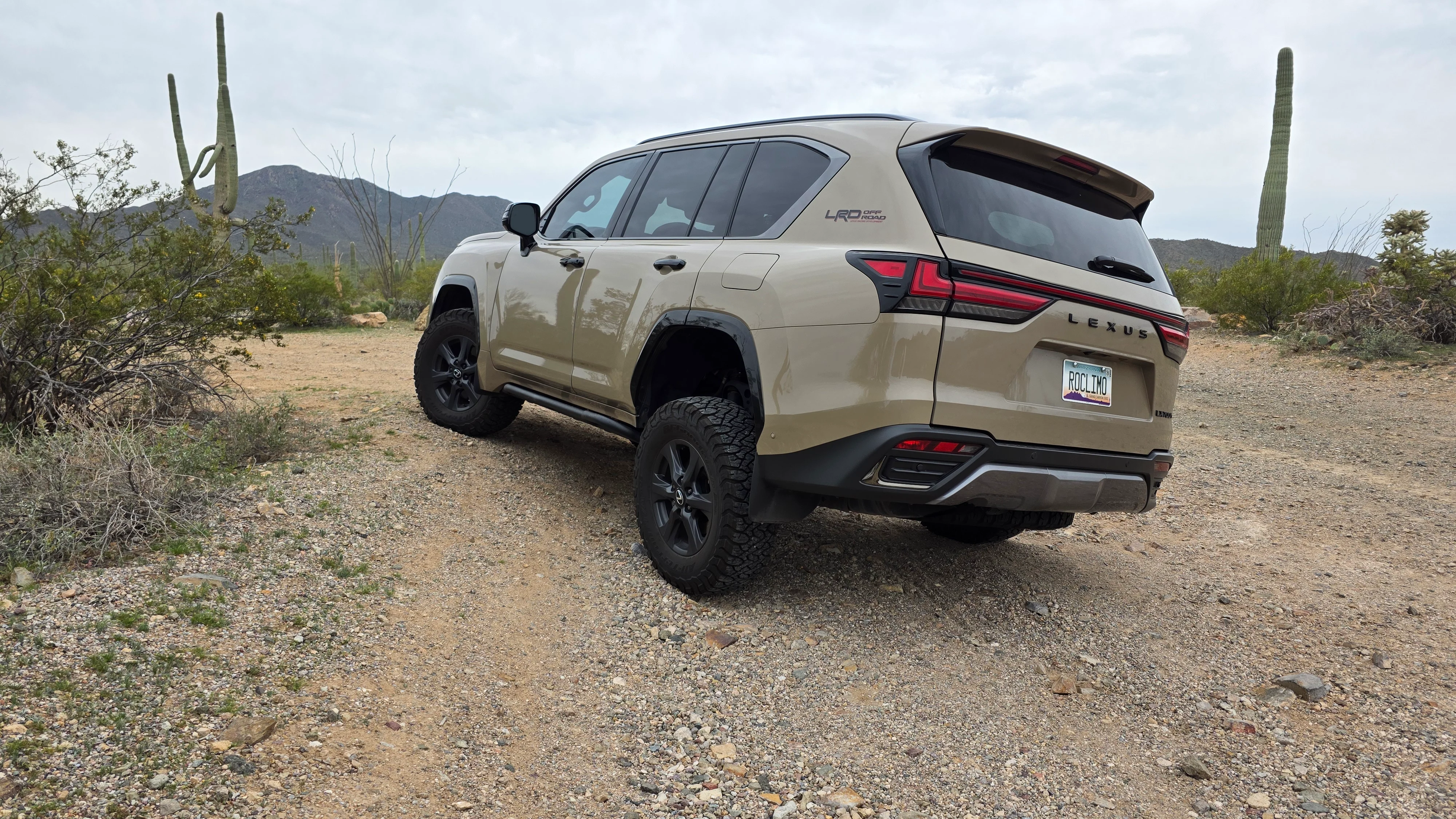

Went with 275x70-18 BFG KO3 (my long time preference on 4 Land Cruisers): 33.2"...just as quiet and the KO's stay that way as they age...ride is still excellent though you can tell you made a tire change to a more aggressive tire. Some little bumps can cause a slight little jiggle. But the ride is still amazingly supreme. And when I'm on the trail I now have confidence. Oh...lost about 1-1.5 MPG (depending) with the change.
