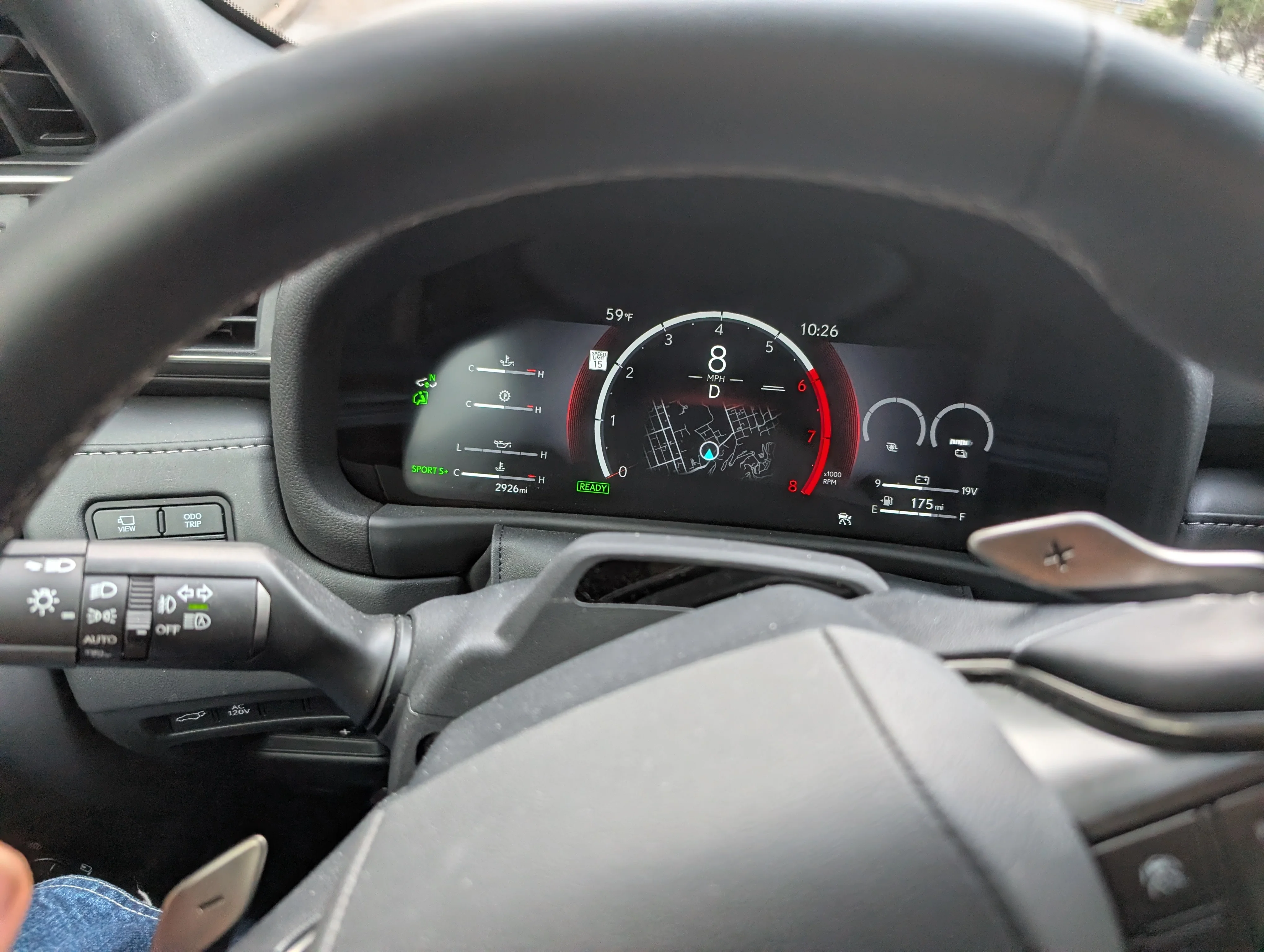

Really? I've been in sport S+ and had the engine sitting at 0 rpm...
